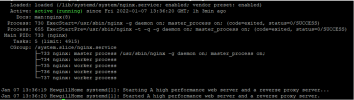

sudo service nginx status
Please provide a screenshot

Hi Chris,
See attached screenshots. Same error occurs when attempting to access via http://<LOCAL_IP>:5000 and http://<LOCAL_IP>:5004. We've tried several reboots but this has made no difference unfortunately.

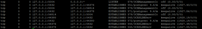

Hi Chris,
I'm definitely using the correct local IP address and can definitely reach it. I'm using PuTTY on my PC to SSH onto the Pi to get the screenshots (pinged the IP for a full minute without any packet loss as well). See attached for the results of netstat.

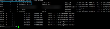

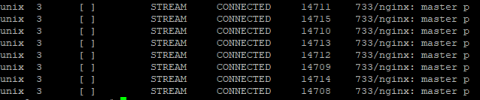

It seems that nothing is listening on port 5001,5000 or 443, try:
netstat -pano | grep nginx
Hi Chris,
See attached for the result of netstat -pano | grep nginx
It should've looked something like this:
If you cannot see this at all then I'd recommend, rather than troubleshooting the issue that you simply redeploy using a backup to restore your configuration as it would be much easier and faster.
