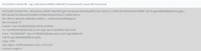

Can someone help me with connecting the Grandstream HT802 device to the alarm control panel, because the following appears in my logs:

In addition, analog modem style devices like this will not fare very well over VoIP due to the inherent latency/jitter of packet switching networks. Your security provider's end will not be able to recognize the signals coming from your alarm (and most likely why the call ends like your logs above). Even if you do get it to work, that does not equal that it's reliable.

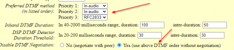

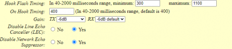

Based on this, you can conclude that the client was not happy with my proposal, so I continued to work with the Grandstream HT 802 device, which fortunately went well, so I am providing the details below.
