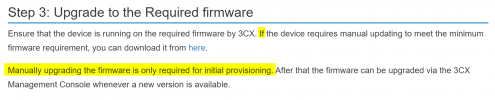

  5. Then provision it as the guide says here, do not use any extension+config filename, just do this part below that I highlighted:
- Your device will now configure itself.
- The username is still admin
- The password is exactly where I showed you
Please let me know if you were successful after you follow these steps, and we can continue from there if you have more questions ;)
Reactions: NickD_3CX
Thank you very much for your help. I was able to configure the device correctly now. What is very confusing is that the login prompt on the Fanvil changes from the HTML styled login form, to the basic authentication prompt after configuration. Using admin and the "Phone Web Page Password", I was able to login after configuration.
I also believe the guide link to firmware should be updated as it is out of date, or remove the wording "running the required firmware by 3CX", which makes it sound like 3CX is only compatible with the firmware available for download at the provided link.
Glad to hear you were able to get it up and running! As for the guide:
Most people today will purchase devices that already come with a way newer firmware than the one that existed when this guide was made, but we want to cover even those that may have found a device with the oldest firmware that has provisioning issues. They need to install the minimum version first.
