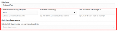

Note that an outbound rule should not be empty. You always need to ensure that you have populated any of the fields shown below. If you already have, when the call fails, what do you see in the event log?
