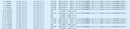

Hi All,
We have a bizarre situation that we are trying to get to the bottom of. We have SIP calls coming in from the Vodafone mobile network that 3CX is not responding to. SIP INVITES come in, but 3CX does not respond. All other carriers seem to be OK. When switching logging onto Verbose we are not seeing the SIP invites in the activity log, but we are seeing the packets hitting the VM's interface when doing a packet capture from the CLI. Below is a screenshot of 2 test calls that 3CX isn't recognizing / responding to. (sorry numbers and IP's redacted for privacy)
I am assuming a 3CX ticket in this case will be a waste of time and money as it's not a supported SIP provider. In saying that, it's a provider we've been using for years with no issues.
I need to try and work out why 3CX isn't accepting / responding to these SIP invites so I can pass information on to the trunk provider for further troubleshooting.

Yes it only seems to be calls originating from the Vodafone network. I have a prepaid vodafone mobile specifically purchased for testing this that I can replicate the issue on. Looking at INVITE packets from calls that work and incoming calls from the Vodafone mobile, there is nothing out of the ordinary that suggest that 3CX shouldn't respond to the Invites.

The only differences I could find are in SDP data.
Vodafone SDP from INVITE
Optus SDP from INVITE
Looking at your capture, it seems your incoming call is Vodafone > Symbio > You

We solved the issue. There was a problem with our Softswitch. Our software provider finally worked out what the issue was. There was a restriction on SIP packet sizes and the Vodafone INVITE packets are longer than the rest due to the additional Media Attributes. It seems the packets must have been getting trimmed and 3CX must have been seeing them as incomplete and ignoring them.
