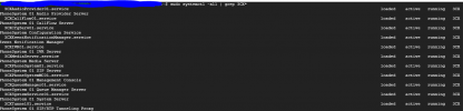

i have found that the services are running
