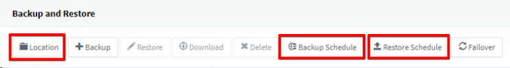

I miss V18, because it was very simple to configure. "Backup Schedule" for active server, "Restore schedule" for passive server, "Location" for both servers. It was absolutely clear.

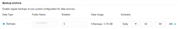

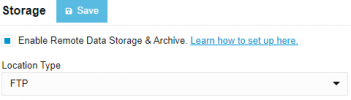

I should specify FTP server here: Admin -> System -> Storage -> Enable Remote Data Storage & Archive
Then, I should specify the restore time on the passive server here: Admin -> Backup -> Failover -> Scheduled Restore
But it won't work. Why? Because I should specify additional parameter that called "Folder Name". And this field is related to backup settings. It's not clear. I am confused. This option is here: Admin -> System -> Storage -> Backup Archive
Moreover this option is cross-linked to another option (Admin -> Backup -> Schedule Backup)
Why this option is duplicated? It doesn't make sense. Because I have to specify the folder name for sure.
