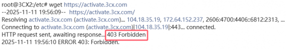

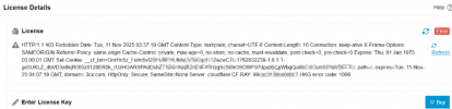

When opening the 3CX server license page, it shows a 403 error with the following details:
The activation server can be pinged from the backend, but when running the command wget https://activate.3cx.com, the activation server responds with "403 Forbidden".
