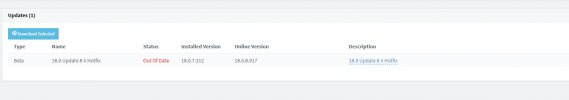

Thanks, so update 8 is required then. Yes it is weird, because they normally advise installing updates via automatic update, not manual updates. Our last automatic update installed OS updates but not the beta, since it's not supposed to do that...
So to clarify, Older builds remain activated, but going to license will stop due to the certificate change.
The system will remain working, but if you want and need to activate it, you must update to the latest update 8 build 917.

So just to confirm. I need to reactivate due to license expiration. There is no release version that will allow me to do so even if my system was in auto-update. So I need to update to a beta version to be able to reactivate?
The update to U8 build 917 is required to be able to activate if below the U7 builds 424 or 441.
The 917 version is the hotfix version for the U8 final.
It's like an egg and chicken situation.. thank you
Based on previous experience, if the license has expired, you will not be able to update to the new version. You'll need to take a backup and then reinstall 3CX and then add your license.
