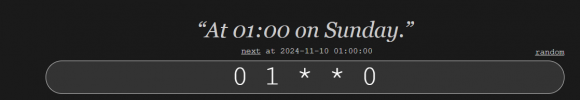

1730800484324.pngcrontab:
0 1 * * 0 cd /opt ; /usr/bin/apt update ; /usr/bin/apt -y upgrade 3cx-* >/dev/null 2>&1
but what about operating system upgrades?
is it safe to install debian updates? at the pbx this is not allowed
ok, i understand
but when i add ?telemetry=true the file is downloaded to the end users device, correct?
thats good that you upgrade the 3cx package itself.
View attachment 44916crontab:

Hi, yes it's safe to update system packages. As long as the VM is fully reserved for just the MCU and you don't have any other software that could conflict, updating your system is totally fine.
Hi @FragFranz , one more detail... for you own security, package unattended-upgrades is installed together with MCU. This ensures you always get latest security updates for system packages.
