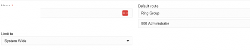

We upgraded to 3CX V20 yesterday on our 'On Premise' installation and am facing an issue with a simple call flow: Trunk mainnumber -> RG Administration (10sec) -> RG Sales (10 sec) -> End call. It keeps redirecting to RG Administration and then again to RG Sales. It does this forever.

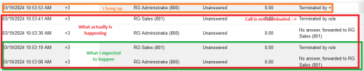

When checking the call log during the issue, it even shows that it is stuck in a loop, it says it is 'Terminated by rule' but it is not.

Trunk config:
RG Administratie config:
RG Sales:
Call log:
