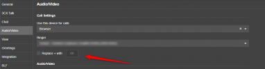

In your Web Client, have you configured this option?
Yes, Outbound Rules (w/ E.164) have been configured to let calls from all extensions out to any number via the SIP Trunk (for the purposes of this trial).
If you configured the outbound rules with e.164 than you need to deactivate e.164 in the pbx options.
