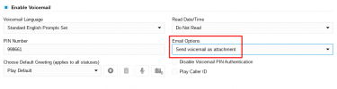

@ahmed24 - one other option would be to enable voicemail to email and have the registered email for extension 4000 be a forwarding email. This way any voicemails that come into this extension will automatically be forwarded to the group that you designate.
