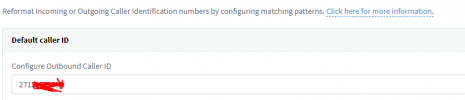

Ok good. Select the "Do not add" option and try the call again.
