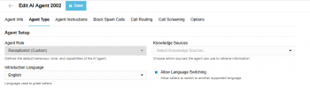

Hi. I have created an AI agent to help with live translation inside a call. I have attached the sample prompt. You can download and use in your instance.
Basically, the setup is
Human agent speaks only english but the caller can not speak English.
The human agent starts a conference and calls the AI agent.
AI agent says : Which language does the caller speak?
Human agent says: "Turkish"
AI agent says :"Ok, I'll translate. Go ahead."
Then the human agent joins the call
When a human agent speaks English, AI agent translates the speech and speaks in Turkish ( everybody hears )
Then the caller speaks Turkish, and the AI agent translates the speech and speaks in English ( everybody hears )
This ping - pong continues until the end of the call.
Any feedback or additional improvement is appreciated.
Did you use the receptionist for this or the personal assistant?
I used Receptionist. It translates any language that we receive claims/requests in the world.

@Marco pbx I'm curious to know what your billed cost is looking like per interaction after using this for a few months. I have a customer in a mixed language environment and I'm thinking of routing their Aiphone through it for translation. Obviously cost is always a factor.
My key is used across projects, I did not calculate only translator, but now approx 0.1 USD per minute, I assume with GPT real-time 1.5
