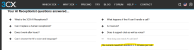

The 3CX website currently states a 3 minute maximum duration at the following link: https://www.3cx.com/phone-system/ai-receptionist/
This is despite the agent having a field for maximum call time which can be set beyond 3 minutes. Can you confirm that the system is definitely capable of calls >3 minutes prior to conducting further review.

Hello @Cody C , thank you for bringing that to our attention. I can confirm that the AI voice agent hard time limit is much greater. But we highly recommend you use the AI Agent configuration option to restrict it down to as little as possible, with 3 minutes being suitable for a receptionist role.
Yes you can increase to what you want.
We set it to 7 min actually for the receptionist. We think that 7 min is more than enough for a receptionist to check who is calling and route the call.
The new customer service agent which is coming soon in update 10, is set to 15 min.
But all these are fully configurable options.
