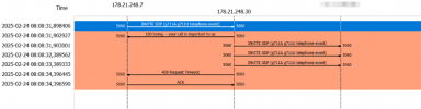

Here's a wireshark capture of the call (incomming call, after about 10 seconds client hangs up)...

From the screenshot it looks that your provider is not replying to the BYE message when you hang up the call making in unresponsive. Once a BYE is received the provider should reply with an 200 OK message for the call to be gracefully terminated which is not the case here.
This can be caused by a number of things but I would recommend starting by contacting your provider and showing them this screenshot or the whole pcap if you have it. They should be able to provide further insight as to why the BYE message is not answered.

I've been in contact with my SIP provider and he says that after they send 200 ACK, then everything they send on port 5060 times out. Here's a wireshark from their end....
