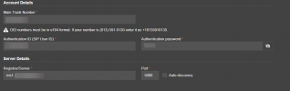

Thanks, this helped with the + Numbers, but if I just dial the wrong extension (for example 1486) in 3CX, it still says, that this number is not connected to anyone. Is it possible to forward numbers like this to the default route?
@Peti your trunk is Registration based or IP Based ?
