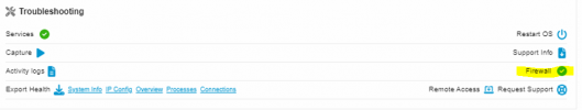

I m using 3cx version 20, and reason we have moved to new firewall fortigate and configure the port forwarding and disable Sip alg and tested the firewall from 3cx system all goes success without any failure. My branch office manage to connected back to system but we found out any calls incoming and outgoing was not able to hear any audio.
Anyone can asisst me on this matter . ?
