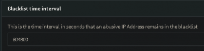

We're having a couple of IP's continually hammering our PBX. When I set the server up I changed the default from 900 seconds in the IP Blacklist to a week:
Any remote users of ours can be unlocked in seconds, but for brute force attacks they can wait a week for a second attempt.

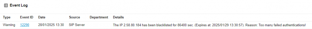

However, I started getting dozens of emails from the same IP's and realized a blacklisted IP was only blocked for 15 min or 900 seconds. (The server is in a different time zone)
Event log confirms this:
In order to stop this, I have to wait until the IP is in Blacklist, then manually update the expiration date by a week (or enter everything manually), which isn't a great use of my time. Not to mention my InBox flooded with alert emails. This is my afternoon so far.
So increasing the Blacklist time interval does nothing. If this function isn't "the time interval in seconds that an abusive IP Address remains in the blacklist" then what does this value do? These IP's are probably spoofed and I doubt the volume of attempts will go down.
We need these malicious IP blocked for longer than 15 min please.

The Blacklist time interval is for SIP registrations. Someone tries to register a SIP device then they will be blacklisted for the default time interval of 86400 seconds which is 24 hours. The maximum time interval is 1 biliion seconds (about 31.7 years)
The 900 seconds (15 minutes) is for web logins.
Thank you Nicolas. Is there a value we can amend to extend this time? If not, please add it to the wish list.
