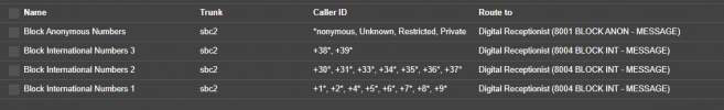

Just to add one idea is to make several rules in the Advanced->CID Rules to block all other country IDs.
Something like this:
The example is I want only Belgian (+32) inbound numbers to come through.
That looks good, why not using it? It should do what you want.

If you use CID rules to block all unwanted callers from undesired countries (and you don't use a CID rule for the desired country, e.g. +32), then for the remaining calls the regular DID rules will be followed to route them to the desired destinations. No need for a call script :)

I did implement this, its working well.
Thanks all for feedback, just wanted to get some validation that I'm not missing something obvious.
