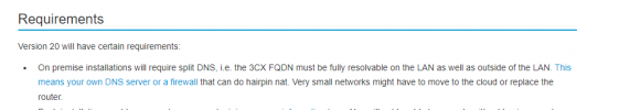

Sounds good, thanks again for the help. Did I also read that in future updates split dns will be required for registering phones on the local lan? Instead of the local IP provisioning link option thats currently in 3cx?
That is what 3CX has stated, but I don't know if it will be possible to work around it. I suspect that a phone that ignores cert errors and that you've manually/option66 provided the https url replacing the fqdn with an IP will still work.
Why not just accept the fact you need split dns and set it up? You can likely do it for free with existing equipment.
Oh im 100% going to accept it and just setup the split DNS, was just curious as to when that was coming as requirement. Appreciate the help today.
Per Nick, it will be required in v20, which is the next major release. Already many things require it, like bridge presence, mobile apps, sms, and more. The best possible source I can give you for this that's public is the blog post: https://www.3cx.com/blog/releases/v20-roadmap/
