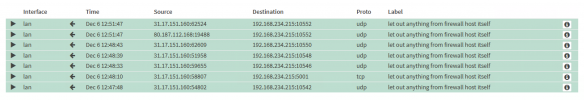

I got this output from my firewall, 192.168.234.215 is the ip of the 3cx, 31.17.151.160 is my current public IP.

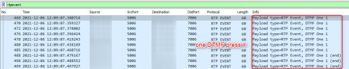

Hi @M4rtin,
I think it would be best to run the capture from the PBX, on the Dashboard click the Activity Log then Settings and enable Verbose logging. Once enabled, click Capture and then make your call.
Hit the DTMF inputs you would normally, then hang up the call and stop the capture.
Download it, and open it in Wireshark. In Wireshark, search the term: rtpevent and you should see your DTMFs:

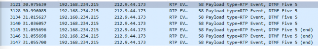

done, I typed 5 one time, this is the output:
Hi @M4rtin,
This is great, you're correct. All of those show 1 DTMF pressed so from the screenshot it all looks correct, can you follow the rest of them and check that the # key is the last pressed DTMF. If so then what is being sent to your provider is correct. I would contact your provider to ensure that they're sending the correct DTMF tones upstream.
Hi @M4rtin,

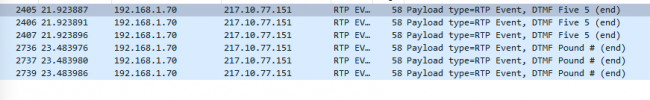

are you sure this is right?

While we would need to examine the full capture to say for sure, this last screenshot you sent does not look correct, no. Before the 3 packets with "end" that signify that the DTMF transmission is stopping for the specific key press, there should be at least one (usually a few) that signify the start f the transmission of the specific DTMF key press.
A typical example is what VasilisV posted above.
Bt the time though, on the system that you are having this problem, you see the DTMFs as display in your screenshot here:
https://www.3cx.com/community/threads/call-breaks-up-after-input-of-hash-key.86238/post-406609
Then somewhere along the way, the DTMFs are being misinterpreted.
