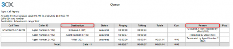

I believe using our reports would shed more light on what is going on. Maybe run a Call Report where the TO field is your Call Queue number and see what reasons are given.

I have looked at the call report.
But I can't see why the mailbox of extension 01703 is used.

Hi @Tyler.Calhoun,
The Call Report should give you a play by play as to what happened to the call and who initiated it.
For example, I call 801 internally from 102:
Agent 103 hits a divert to VoiceMail, here it tells you that Queue was replaced by the VMail of 103 in the Reason column.
