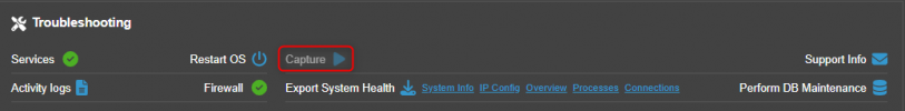

For a WireShark capture, would you recommend using the "Capture" feature on the dashboard? I believe this is actually tcpdump, since it's a Linux box. Or should I run a WireShark capture on the phone itself?

We have also made it easy to do a capture from the PBX interface itself.
No TCPDUMP or TSHARK required.
Just do it from the interface.

I captured 22 seconds of traffic, which should include the initial moments of a call. It's 3000+ lines, and I'm not exactly sure what I'm looking for. Does 3CX have any tips on interpreting its Wireshark output?
