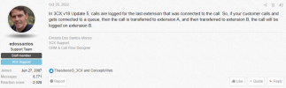

In 3CX v18 Update 5, we found that the transferred calls will combine agent 1 and agent 2 call to one call journal. Can we have previous feature or other setting can make it?
is it possible Split Call journal to extension A and extension B ?
No, each call will be logged only once, for the last extension that was connected to the call.
why old version can and now remove it? We need it to record agent support time seperately when transfer.
We made this change in Update 5 in order to fix other important issues. For example, before this change, missed queue calls were not being logged. Now we have a system-wide perspective of the call, so each call is only logged once. I understand that this might not be the best solution for all cases, but unfortunately there is no way to customize this behavior at the time being....
