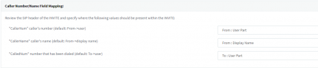

Tenemos una integración que estamos realizando con nuestro CRM, pero tenemos un inconveniente con el call journaling, en el CRM template generator pusimos el api para que nos haga los post 3CX de las llamadas, pero no se estan generando, no sabemos porque o que puede estar pasando del porque no entrega reportes, pensamos que era porque no estaba creado el usuario que estabamos llamando de salida, pero si estaba creado, nos aseguramos que el numero coincidiera y lo reconoce y nos da un contact url para abrir la info del cliente, pero no tenemos el reporte de las llamadas, capturamos las api a un webhook y nunca llega nada.
Pongo unas fotos y un support info file a ver si hay algo que nos puedan ayudar para saber que hace falta.
This seems to be limited to the sip trunk. Try the inbound parameters settings like below example and check the behavior:
Ok Theodoros, I'm gonna try this tomorrow, and I will let you know what happens, in case if this doesn't works, what else can I try?
There seems to be an difference on the caller id received so most probably you need to check this first.
I take it, thanks, I will let you know how its going
Let me know the outcome

The issue is here, as you can see the number comes with a different format. If all inbound calls are coming with this format you might need to consider the caller id reformatting to resolve this issue.
Theodoros, you are the man, I was trying this all day with another supplier and it worked, I tried it from the beginning with it and it worked, I found what you say, changes the number, but I saw no solution, of course, reformatting the number is the solution, Thanks Theodoros
