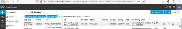

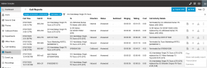

The Outbound call. Was it a direct dial of the external number, or is there any IVR etc involved?
Dear KS,

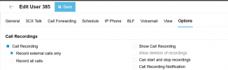

It was a direct dial of the external number. Could you please advise? I need to change it to record all the calls instead of recording only external calls.

They are dialing using the 3CX desktop app; however, they have integrated it with the LeadSquared CRM. Could you please confirm if changing the configuration to "Record All" might help resolve the issue?
