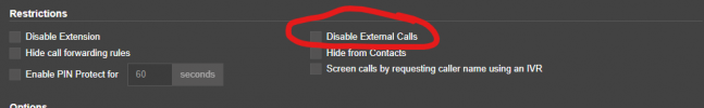

There are a few ways to go about this that I can think of. Ill order them in what I think are best to worst.
1) You can disable outbound calling in the extension directly. This is probably the best option, but does require editing every extenion. If you are importing the CSV of all the extensions then you should be able to do this quickly1738854609749.png
2) Add them all to a department then make an outbound rule for that department with no trunks assign. You will have to have 911 setup in the emergency section as that gets processed before the outbound rules. This is a bit hackish
3) Exclude them from any dialing rule. 3CX requires a dialing rule match to call out. You cant call out if you dont match so dont let it match. This is obviously the worst idea of the 3.
Personally I would go with option 1. It clearly lets you know the extension has outbound calls disabled.
1) You can disable outbound calling in the extension directly. This is probably the best option, but does require editing every extenion. If you are importing the CSV of all the extensions then you should be able to do this quicklyView attachment 46307
I hope that helps.

Option 1 would be your best bet. Disable external calls for all room extensions.
