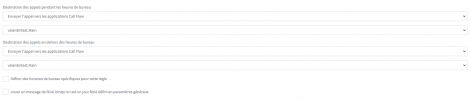

I'm not sure I fully understand
I already have a CFD as input to my did
1687938340629.pngIn your solution, I have to make a CRM request, that's what I don't understand, should I use this option in the CFD?
If yes I do not understand how this option works, it does not only expect input parameters?
How should I take it?
Using this CFD component, you can do the lookup by phone number, and pass the variable session.ani as parameter. But this is not enough for you, because you need to send the called number too. So you will need to manually invoke your web service using the Web Service REST component. The called number is in variable session.did, as long as you have an Inbound DID rule for this number. Then you will need to analyze the JSON response, you can use the JSON / XML Parser component for this. Then you will need to set some properties by attaching data to the call, here you have the details of the 3 properties that you will need to set:
