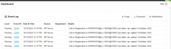

I have a problem when calling external No . Before, there was no problem and the call was successful. Now I get these messages.
i'm using GXW4104

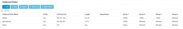

Check your outgoing rules
This call can only use the mobile rule (is this extension in there?) or the vision rule. Is this correct?
vision its rule

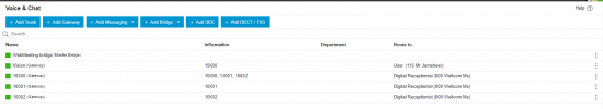

i have 4 trunk
10000
10001
10002
vision
0,1&2 for all company section
vision for privet section

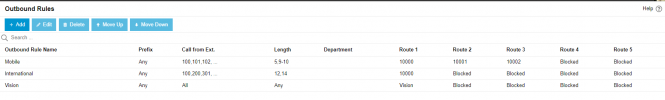

I thought the channels were changing so I delete the Vision Ext . and set it back again
No its limited to extension 115, is this correct?
yes trunk vision only for extension 115 send and recive calling

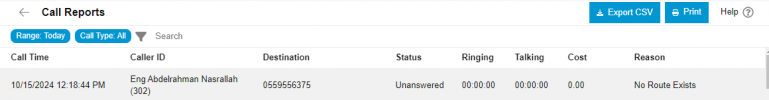

Does it work for now?
no it's not work
Whene i make call it's send for all trunk used for mobile one time
Is the extension in this outgoing rule
