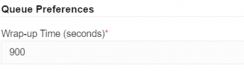

Could be wrap up time is too high and the PBX is giving the agents some time to rest?

Hi Ivank,
The Wrap-up Time is only 180 Seconds. I don't think that could be the case.
180 Seconds of downtime, any agent in the queue that has taken a call is now offline, try resetting to something less, most are set for 2 or 3 seconds that allows agents to be back in the queue for the next call

Wrap up time is the amount of time an agent has after a call to wrap up the duties of that call. For that amount of time their extension will not ring for other queue calls.
