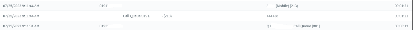

I'm just trying to work out what the issue might be for one of our customers and hoping someone can help please. Basically they're not getting calls on their mobile when someone is going through to the call queue. I have anonymized the call log data below but you can see the call comes in on the Call Queue 801 and then seems to call 213 once then 215 a number of times before going to voicemail it seems?
213 (07384) and 215(07900) are both mobiles listed under Users
I have made another change by going into the Desk Phone (Fanvil X3S) on the PBX and set it to call the mobile simultaneously and added the mobile number in there this morning but the saw that yesterday it seems to log a call to that mobile number about 10 times before going to voicemail? Is that normal?
There are three mobiles in the call queue and another seems to receive calls from the queue fine:
This is a call from an 0191 number which goes to queue 801 again and gets answered on the mobile (213).
