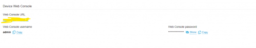

You can try logging in the DECT base and running an autoprovision. This has worked for me in the past with similar issues
Not sure why, but the base will refuse the standard admin admin username & password...
When you provisioned the base in the 3cx system, it gave it a password. I usually work from the Management Console so I don't know where it is in the Webclient.
Edit: found it in the webclient
