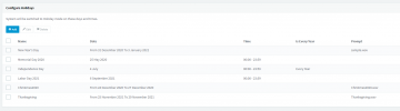

Regardless, here's a screen shot of the holiday table. I forgot to note, that this was a restored system that I moved from on-prem to self-hosted.

As discussed via PM, the issue has been identified and will be addressed in V18 U3.
In the meantime, anyone else facing this issue can check for holiday entries that span across two or more years. Split them into two or more entries so you have one entry per year.
