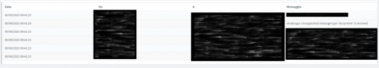

normal text arrive but who someone sends an attachment i get the error: whatsapp: Unsupported message type 'document' is received

both webclient and desktop app. From chat log too. see.attachment

from web/desktop
