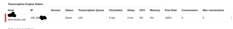

There's a problem with the trans server.
The server was installed two months ago and was working fine.
Yesterday, it was down. In the 3CX panel, the status is down.
I deleted the existing service in the 3CX panel and added a new one. I copied the installation line to the transcription server. But during installation, the SSH console displays the following error (cant download):

Finally, we install transcription server without errors (throu other internet connection) But status in the 3cx server - down.
What we can do for diagnose?

3cx FQDN. What we see now on PBX
Have you added the transcription server host name ...wmr.my3cx.net into the windows PBX server host file, or on your gateway/router as hairpin NAT / internal DNS?
That is, from the PBX if you ping that hostname, it knows to go to the 192.168 IP? And the reverse, if you try to go from the transcription server to the pbx using a hostname, does it work?

Thank you very much!
I correct hosts file and it go online.
