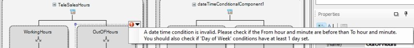

I need to configure 3 queus with different time in the same day:-
The first queue working hour from 10 am to 7 pm,
The second working from 10 am to 9 pm
the third working from 10 am to 10 pm
I created cfd app but I have an error in set time range

The one from 19h to 8h, should be created as two entries in the same conditions dialog.
One from 19h to 23h59, the other from 0h to 8h.
