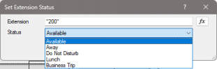

No need for that. This can be done with CFD standard code blocks.
Change the mobile number for the extension with the CFD code block Set DN Property, Extension (the number) as string, the Property Name "MOBILENUMBER" (even a string) and your mobile number as Property Value as string in quotation marks.
Change the extension status with the CFD code block Set Extension Status.

Your logic requires the CFD code blocks GetExtensionStatus, CreateCondition, UserInput or PromptPlayback (with DTMF input, your choice; you can try both yourself), SetDNProperty and SetExtensionStatus. All of this in the correct combination with the correct parameters and it will work.
