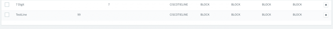

And here are the Outbound rules I used....Screen Shot 2021-06-14 at 11.16.04 AM.png
ok Yannis, I have 3CX to Cisco working... I can call the PSTN from a 3CX extension to PSTN trunks on a Cisco Call Manager, or CME....

Lastly here is the call log on the Cisco CME, and the 3CX to prove the point....
