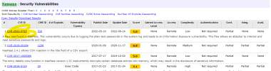

You should be asking keepass if your data was stolen as I found this:
It cant have been a brute force attack otherwise the IP would have been blacklisted (depending on your settings).
so, someone knew the password.
Reactions: CTK_Fabian and nub
If you regularly close the Keepass app then it is kind of hard-to-get data out without insider knowledge.

That the data was stolen from the different Keepass files is also very unlikely. Each client has its own file with its own keyfile, all our clients + servers are protected with Sophos Intercept X Advcanced. We have no other anomalies with other installations or systems. ( in the Keepass files not only the passwords of the 3CX were stored / partly the Keepass files are located in different drives ( security areas ) on our server )
Since our changes nothing has happened so far, we just wanted an answer how this could happen....
