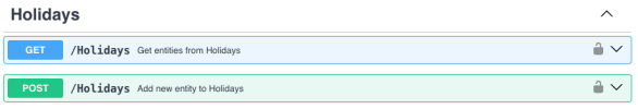

I should also point out that you can use XAPI to make changes programmatically:
