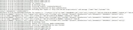

Again in Trouble. 3CX seeding POST requests but No Contacts created in CRM. and i tested with POSTMAN getting results and contacts created. . any clues?
The screenshot shows a successful POST request, with a valid JSON response. If that's not creating the contact in the CRM, maybe it's something to check on the CRM side. Also, you can compare the requests being sent by Postman and 3CX, and spot any difference...
Thanks For Response ! So this is clear that there is no further changes required to do in 3CX Template right ... Ok. I do the needful!!:)
