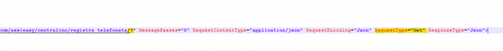

I'm attaching the demo template.

for you what is the problem in the XML?
Remove the random ? from those URLs.
Then, change GET for POST. You're trying to post data via a GET request which will never work.
Other than that, without seeing the actual logs, can't help much further.
The "?" is in the link provided by the CRM technicians, and they also told me to set the call in GET instead of POST.
It still doesn't work,where can I find detailed 3cx call logs to figure out where the error is?
Well this will definitely not work as GET in that way. Not sure why they say to use GET for posting data.
