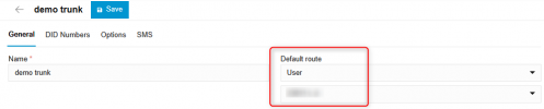

Regarding the Ring Group, is the user that's ringing set as the destination of the default route in the trunk? So open your trunk settings and check the default route. Is that user set there?
Thankyou. The Ring Group is now correctly correctly. However we stillhave an issue witht the outbound rules. I have added 90298202800 and strip 1 the first digit, but it did not work. I have change the
