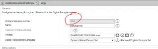

I've been working to upgrade our 3CX system from (I think) v14 to v16, but I've had some difficulties. I arrived at this company after-the-fact and the last tech didn't leave any instructions or documentation to our phone system layout, and I've been left alone trying to solve it all with no prior experience in phone systems. We have two gateways, one Patton and one Grandstream, which seem to be splitting one phone line into 5 simultaneous lines. We also have some boxes which are unlabeled aside from a company brand "Arris" on them, I cannot find them on the network so I'm currently unsure what they do.
Now I'm currently working on some other settings and fixes and I noticed the digital receptionist is locked on a virtual extension and cannot be edited. I'm guessing one of our pieces of equipment has locked it for some reason? We were looking to start programming "company hours" into the system and need to be able to build a new receptionist and 'swap the extensions out' eventually...
Any assistance on this would be appreciated. We use yealink T29G phones, mostly outdated firmware (I'm also working on that).
Hopefully to v18? It went 14->15->16->18.
The DRs are not real (user) extensions so there's no need to change numbers. They are not usually dialed except while testing changes. The DR typically directs the call to an actual extension, ring group, queue, etc. The SIP trunk or inbound rule would normally route the inbound call to a DR, just change to a different DR there.
v14 cannot jump straight to v18, so I had to start by moving it up to v16. Calls coming in go straight to this auto-attendant and otherwise just time out to an extension voicemail. I need to completely redo the auto-attendant, hence I figured designing a new one and then just "swapping" the extensions would work as to avoid deleting. Unfortunately, it does not let me edit the extension, which is why I was guessing one of our phone boxes was the culprit.
Create your new Digital Receptionist. On the SIP trunk, set "Route calls to" to go to the new DR extension. Then you can delete the old DR at your convenience.
No extension numbers are editable after creation, whether it's a user extension or not.

What determines which digital receptionist is used? Is it controlled by an external piece of equipment, like one of the closet "boxes" setting the virtual ext to 804, or is it controlled via 3CX?

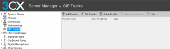

A SIP trunk has its configuration for inbound routing. Also an Inbound rule can be set up for alternate call routing.
So one of the boxes in the closet has the number "804" set somewhere? Bear with me, I wasn't taught phone systems during my training (haha).

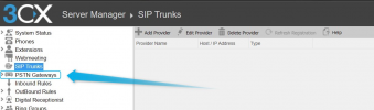

Check PSTN Gateways, maybe using ISDN2 or PSTN lines
No luck, we have two gateways with one holding 1 call line and the other holding 4. Don't see a lot of configurable settings.
I'm not seeing anything that would suggest a manually entered agent or extension.

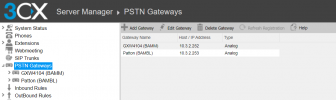

To help clear things up a bit. The boxes you mention are probably the PSTN gateways, very simply put, they convert the Analogue line to a digital one (SIP) so that the 3CX PBX recognizes it. That said, if incoming calls work in general, you should not need to do anything with those so leave them as is.
Everything else, IVR extensions, normal extensions, routing of an incoming call in general, is handled by the 3CX PBX so you should be able to configure everything from the 3CX Management Console.
So, let's say that what is happening currently is something like this:
"Incoming call from Provider >> Goes through PSTN Gateway >> Reaches 3CX >> Goes to IVR 804 >> Is routed based on selection"
It means that, anything from the "Reaches 3CX" point onwards you can and must only configure via 3CX.
Going back to what @Saqqara said, I think he was referring to the "PSTN Gateways" section in the Management Console:
Do you have anything under that section? If you are receiving external calls then it means you must have something set on the PBX and if you are using actual gateways then the "PSTN Gateway" section is where the configuration for incoming calls probably lies. It is in that section where you are probably specifying that calls should go to IVR 804 and it is there where you should be able to change this routing.
I've dug through the web interfaces and the settings in 3CX for those gateways, nothing jumps out at me. I don't see anything setting the digital receptionist or the line 804.
I've gotten the gist of how this logically works, dividing one incoming line into multiple "virtual lines" using the PSTN gateways. Why and how it works is beyond me, but the logic I think I've caught at last.
