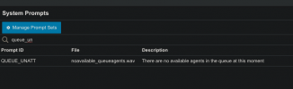

I do not remember ever hearing a message "There are not enough agents available in the queue at the moment'. I was under the impression that when a caller is transferred to a queue with no agents logged in, it immediately transfers the call to the "no answer" destination. Did I just never notice this message?
@VoIPTools - yes, there is such a prompt - QUEUE_UNATT
