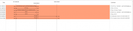

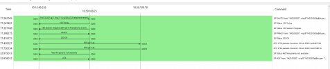

We successfully configured SIP Trunk, and DID, and everything is fine except DOD. When making calls the main number is showing at the callee end. Kindly check the network trace and DOD rules in 3cx and please advise with a resolution.Please check this screenshot also.

in old pabx was also its fine , through 3cx is the issue and DID works well
Does the PBX sent the caller id as expected?
The PBX will sent the information according to what you have configured in the outbound parameters.
Since this is not a supported provider you need to check from their side.
