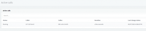

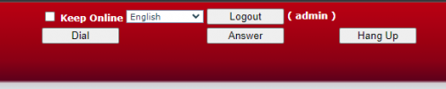

Ok perfect, one last thing to check on your i30 web UI:
1. Press Dial here
2. Enter an extension that you know is good and works, then press OK
The doorphone will try to call you - see if the call rings from your management console by clicking "Number of calls in use"
You will see the call happening here live if it works.
Tell me what the result was, what did you see exactly during this test?
Did you click on Number of calls in use to confirm the call is made?
YES, no one at the office now.
Ok so if the call is being made, you need to click the doorbell button now and check the active calls again.
You will probably see the call being made and the destination extension might be rejecting your call.
So far the i30 seems to be ok then.
