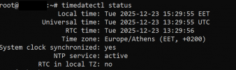

can you run timedatectl status and share the output? From first glance it looks OK, but best be sure.
OK, this would confirm it's not a timing issue. Perhaps with logs in verbose mode we can get some more info of what the root cause of the problem is.
